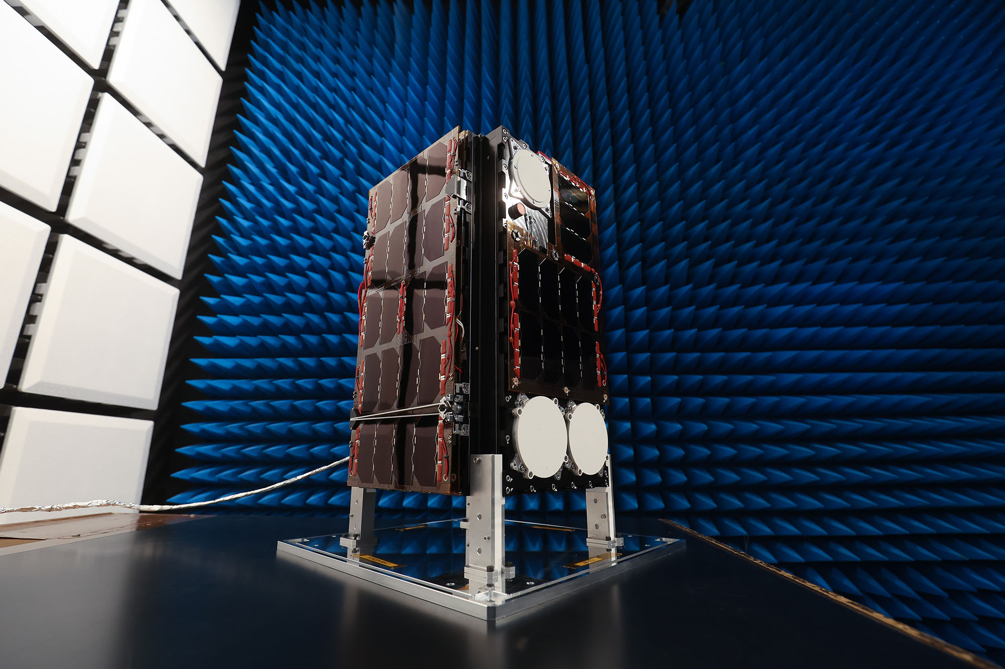

CubeSat od firmy GMV pro misi Celeste.
Zdroj: https://www.esa.int/

https://www.esa.int/…/Testing_GMV_s_Celeste_In-Orbit_Demonstration_CubeSat_in_an_anechoic_chamber.png
